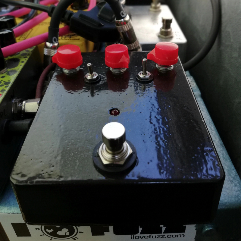

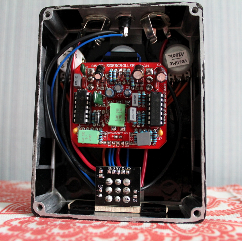

I finally finished the Sidescroller a month or so ago. It took a long time bcuz of components arriving slowly and general boxing-related stuff. Added a 56k resistor between R1 and R4 to make it less sensitive/more gated, might go back and mess with that some more. Black Hammerite paint, no markings, I know what the knobs do by now. Rad synth fuzz that makes u see Sonic sprites.

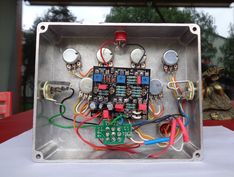

Here's a thing that has been on the bench for a while. It is a CODA Effects Black Hole, a Model T inspired preamp (4 x J201) with a boost (LPB1) in front of it. The boost was meant to be on a DPTD switch (or footswitch) with an internal trimpot to set the level of the boost.
I decided to have the boost always on and moved the potentiometer to the front. I also put C1, C2 and C7 into sockets, so that I could easily swap those caps for more bass if needed (I use it on bass). Although, using the 3 band EQ, it can get pretty bass heavy with the stock values.
The pilot light didn't function as intended via the footswitch board, so I had to run more wires than planned first ...
 Looks a bit messy over there.
 Looks a bit messy over there.Anyway, the light works now (and is red, of course).
This could have fit into a smaller enclosure, but I wanted to put numbered knobs and a jewel light on there to give it an amp like appereance - and I like big pedals!
