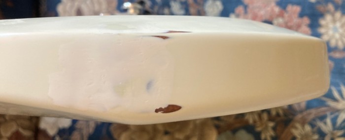

on the other hand, the side ding wasn't nearly as successful. i was able to mix a pretty close match to the paint color and get it applied consistently to the problem area. however, once again the (tinted) white CA was unable to cover the darker imperfections. it was also a screaming bitch to sand, and in the process some additional spots got the paint sanded off. you're supposed to be going in the opposite direction, dammit.
at this point i'm declaring CA, at least in the StewMac formulation, ineffective for finish fixes other than small drop fills. i'm quite disappointed given that they represent otherwise. i guess the next thing will be to find some Vintage White paint that won't fuck up the extant poly finish and go for a Kondor-style coverup of the bad bits. i'll still find some way to make it look OK, but i really didn't need the letdown on a Monday. oh well. i won't get back to this till Wednesday because i'm going out to Becky's straight after work and thus won't have time to shop.

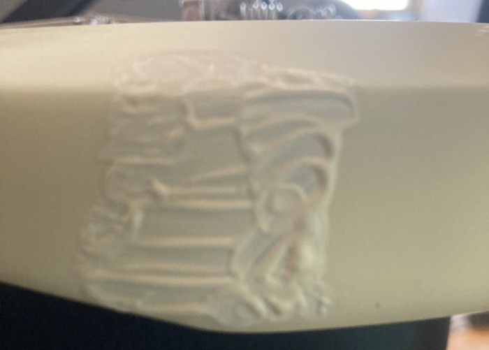

i found some satin finish Vintage White craft paint at Michael's which isn't quite an exact match, but it's pretty damn close. it wasn't doing a terrific job of covering the dark spots so i rather troweled it on. i'd rather sand more than sand through. the headstock seems to be coming along quite well, and i'm managing to get a decent straight edge between the black face and the white side.
the side looks to be a bit more challenging because of the dark areas of exposed mahogany. i'll do another coat here and then carefully sand down till i get a reasonably flat surface.
assuming i can get a decent flat painted surface, the rest should be relatively simple. a couple of coats of clear brush-on poly, some judicious sanding and polishing, and we should be rolling. they say to leave an hour between coats, but i'm not doing another till the afternoon (it's 0845 now). if i have one big takeaway in filling and sanding, it's that it almost always takes way longer for something to dry and harden than it says on the can. but i feel better now...i may not be able to match the OG paint perfectly, but at least the flaws won't be visible from 3 feet away. it's also possible that the clearcoat might balance out the colors as happened with the sides of the Kondor body.
