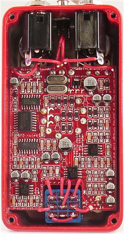

Stan, no problemo buddy, here's a pic of the inside of a miniberator...
Final Miniberator Proto.JPG (52.49 KiB) Viewed 6066 times
I started the design with the intention of not using a battery but I think if I did a 4 layer pcb and switched to pcb mounted jacks I could find the room, I'd see it as an awesome challenge and I love doing pcb work. Another factor is the size of smd components I chose to use, I use the biggest size available in the miniberator, 1206. I feel like it helps to bridge the gap between through hole and smd, it's easier to like smd when it's nearly the same size as through hole and has the exact same power handlings and tolerances.
I feel complicated about batteries in every other pedal but the RRR, there's just no point in the RRR as it wears a battery down so fast.. like 30 minutes fast with the carbon batteries we include with the pedals. I can't bring myself to design around batteries, I do what's best for the sound and the circuit and I don't consider battery life as important at all and I really do think it's a good idea to not even have a battery snap in the box. Especially with how many awesome power supplies are available, even the less expensive switch mode supplies work great, usually even daisy chained.

UMMM... yeah, there's isn't an emoticon to express how hard my jaw hit the floor when i saw this design pic.... ryan, it's been a real honor and pleasure to be able to pick your brain and check out your designs and understand how you think... your pedals really are great examples of total effects designs.... :thumb:
