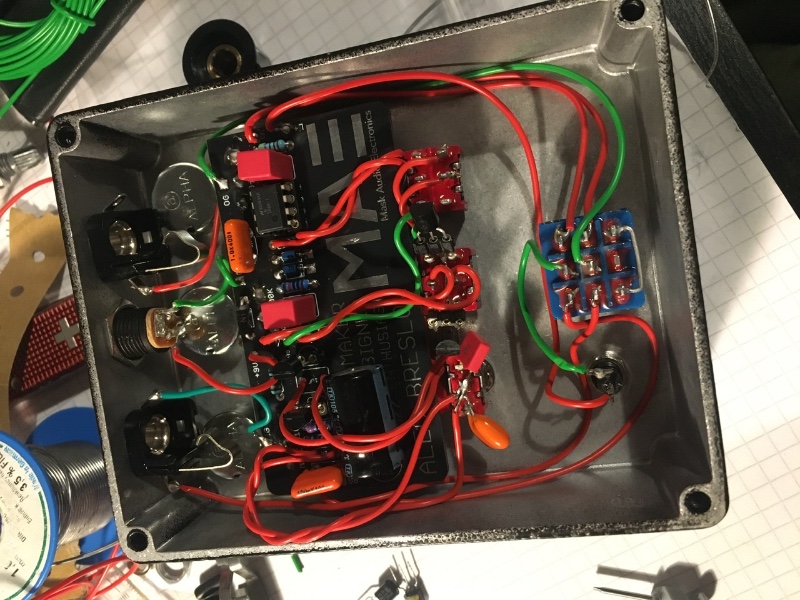

This is my "Perhaps?!" fuzz: built using MAE Business Card PCB, it's basically my own mix of Yes & No fuzz pedals.
Controls (left to right, top to bottom): Volume, Tone, Yes' More, Octave, NO's Thud.
Switches (left to right): 386 low-high gain, Q1 PNP/NPN switch, 3 position Yes' Splat (1nF, off, 10nF)
Stil trying out some transistor, but it's a messy, funny fuzz!

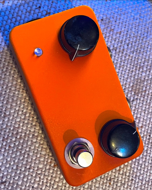

I rehoused a ggg orange squeezer kit I put together 16ish years ago… not showing a guts shot.. I barely got it all in :lol: the pedal was originally the normal Mxr layout… the enclosure is recycled from another old project that I never really liked… only mod to the design was I changed the input cap for a larger one so it works better on bass.. I painted it with orange safety paint

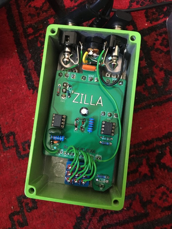

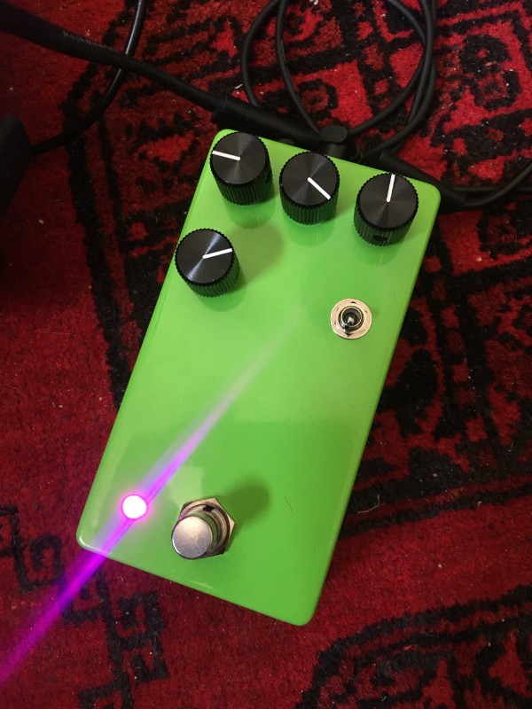

Put together another stellar PCB by Deadend Fx: this time the Zilla, aka the Lastgasp Green Monster clone.
I did used to own an orginal at some point (of which I took the detailed pictures that Deadend used to trace the pedal!), then Deadend sent me a pcb as a thank you for the pictures, I built the clone (which is spot on as the original). So I sold the original, and kept only the clone, which... I sold too at some point..
Lately I was craving again for the rotten tones the Zilla/GreenMonster can generate (also to compensate a GAS I was having for the Mattoverse AirTrash), so I ordered a new pcb and built it again. On this one I did few tweaks to have a bit more disgusting range available:
C4 120n
R7 680k
R3 7M (4M7+2M2)
R5 15k
D1& D2 2x 1N4148 on both sides
Sens1 & Volume 100k
