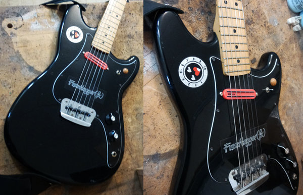

Updated Duo Sonic pics. :) Still LOVING this thing.
Posts: 42228
Re: Dimarzio pickups / Tone Zone S (in my Duo Sonic)
Yeah, that's pretty hot.
Tom Dalton wrote:Updated Duo Sonic pics. :) Still LOVING this thing.
Nice! The black and pink is rad. If I didn't hate neck pickups I would love this guitar even more.
Well, if you ever try a Duo, the neck pickup might please you. Somewhere between the Duo's short scale, its bridge plate, or the aftermarket Alnico Vs, or the aftermarket aluminum saddles...the neck pickup in this sounded like the wrath of a hundred tele bridge pickups.
Hence the Graph Tech saddles & the Tone Zone in the neck. :) Brings it to middle-to-neck pickup territory.
