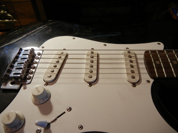

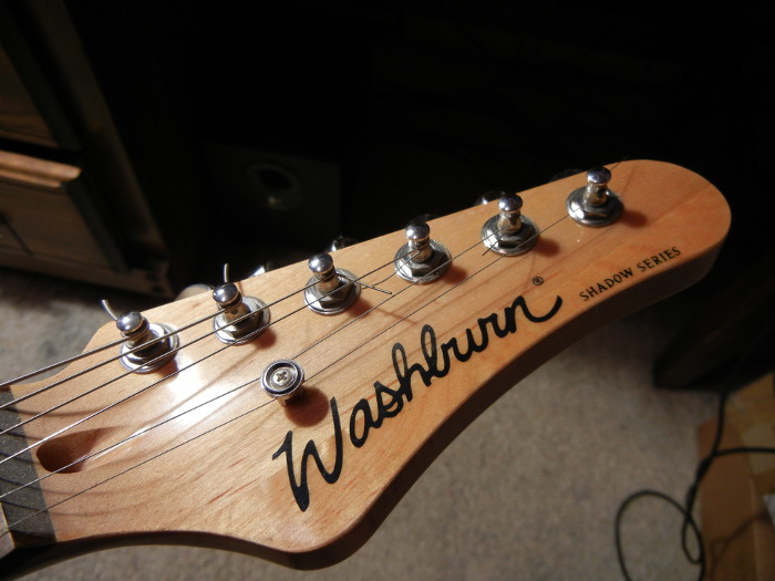

My neighbor randomly decided to give me this guitar today. I think he'd seen me working on my previous two projects and decided to see if I wanted it, because he said he was going to throw it out otherwise. Of course I did.
I've never heard of this guitar, and a quick google doesn't turn up hardly anything.
-Washburn "Shadow Series" strat knock-off
-Measured the neck, it seems to be of standard strat dimensions, like you could put a warmoth neck on it. The dude said he thought the neck was warped, but I think it may just need a good intonating and truss-rod adjustment. I still haven't plugged it in yet. He gave it to me like 30 minutes ago.....
I got a pile of spare pickups laying around, but no single coils. A while back Sonny traded me a cool bass pickup that I've always wanted to throw in something....and I have a handful of oddball HBs..... If the neck doesn't need straight up replacing, I'd like to try some weird shit on this one. Unless you gaiz know where I can get a strat-dimensioned neck for cheapz. I'm moving in a few weeks, so I can't spend much on this, at least right now.
Y'all got some suggestimications?

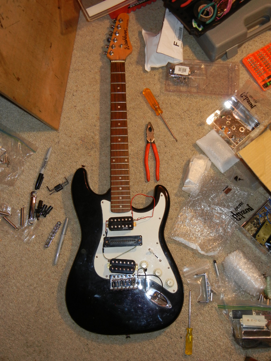

Tore the thing apart today. Upon closer inspection, the neck is a little warped..... BUT the scale and neck pocket are pretty much to exact Fender Strat specs..... I'm gonna go hunting for a crap guitar from the pawn shop or something. Hopefully there's something out there with a non-strat headstock.....

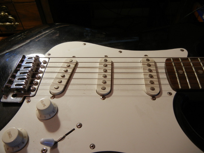

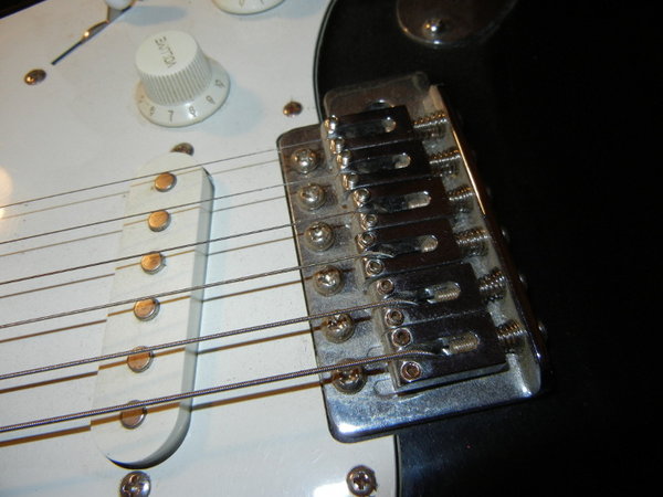

Also, the bridge is a little weird. Is it common to have strat-style tremolos that just screw into the body? Maybe I'm spoiled having a G&L as my actual strat-style axe...but it seems like you'd want something mounted in between the bridge and the body
So I'm going to fuck with that, too.
I'm playing with this mockup, at least until I get a couple different parts

Classic six-screw Strat trems are screwed right in. Standard stuff. You could always get a cheapie Wilkinson and sink mounting posts in if you want a more modern setup. If you want a direct replacement six-screw, watch the string spacing and screw spacing. 10.5 mm spring spacing is entirely different from vintage Fender and not well served in the replacement parts market.

you want to leave a little play in the screws though with the end ones setting the height. the bridge should be able to pivot on the screws.
